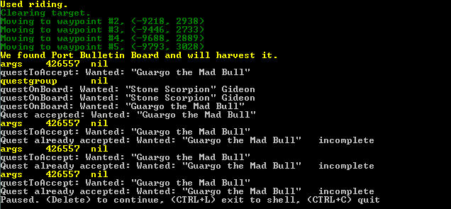

Here is a version of function.lua with some print messages. Try this and show me the printed messages.
- functions.lua
- (89.26 KiB) Downloaded 284 times

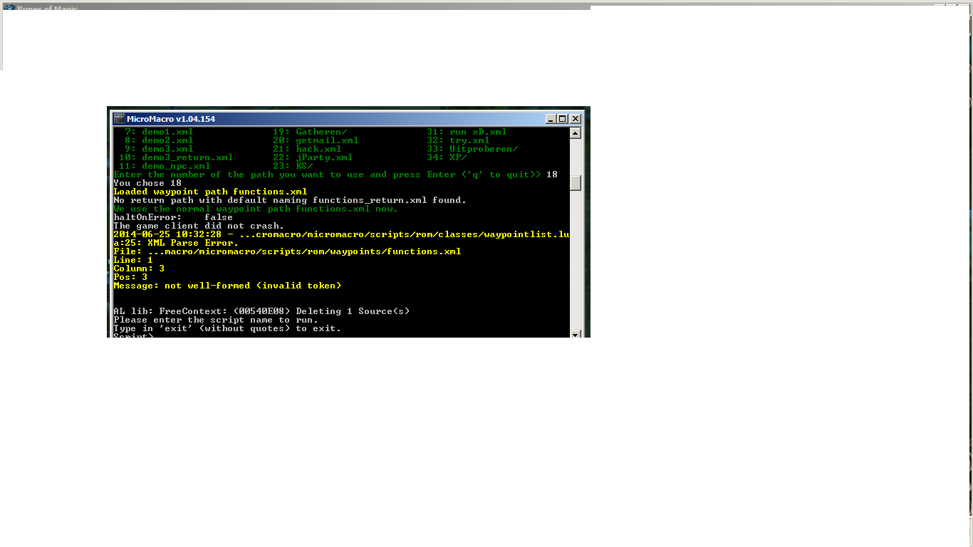

Re: Wailing Fjord Daily/Public Mad Bull
Replace the function.lua file in the micromacro/scripts/rom folder with this one. Then run the bot as before. It should print some extra messages while it's running. When it gets stuck copy and past the MM output here so I can have a look.
Ok here it is :
Think the xml didn't load properly i guess.

"functions.xml"? I posted a "function.lua". An .lua is not an .xml. The "functions.lua" file is in the "rom" folder not the "rom/waypoints" folder.

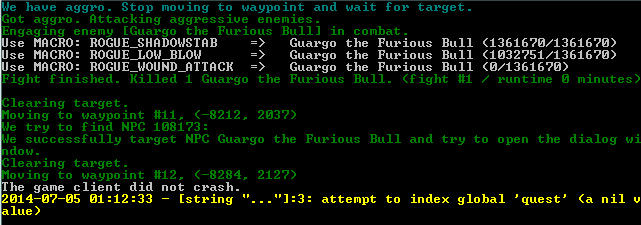

Thought I had done that.
then I tried
Actually gets me moving, but after I kill elite
Have lisas function (http://www.solarstrike.net/phpBB3/viewt ... 721#p35721)
Have your userfunction (http://www.solarstrike.net/phpBB3/viewt ... 676#p40676)
function getquest()
quest = questlog:haveQuest(426557, questtype) -- Wanted: "Guargo the Mad Bull"
if quest == false then
player:target_Object(122806) -- Port Bulletin Board
yrest(100)
AcceptQuestByName(426557)
yrest(200)
until getQuestStatus(GetIdName(426557), questtype) ~= "not accepted"
Did it have the quest?
Looks like you haven't yet. I ask some questions which you still haven't answered.i1own0u wrote:Thought I had done that.
- 1. Do you have the latest questlog userfunction installed?
2. Which quest are you trying to accept, the daily or the event? (That's from the questtype option at the top of the file)
3. When it accepts the quest, is it the right one?
4. Do you have any addons that autoaccept quests such as DailyNotes?
I did replace the line with your line. I replaced both lines with your line.rock5 wrote:Did it have the quest?
Yes.
Looks like you haven't yet. I ask some questions which you still haven't answered.i1own0u wrote:Thought I had done that.Yes. I have tried with dailynotes both on and off. I get the same results regardless. After killing elite, that message appears.
Yes.
2. Which quest are you trying to accept, the daily or the event? (That's from the questtype option at the top of the file)DailyCode: Select all
questtype = "daily" -- "public" or "daily"
Yes (Daily)
change
until questlog:haveQuest(426557, questtype)Code: Select all
until getQuestStatus(GetIdName(426557), questtype) ~= "accepted"Code: Select all
until not questlog:haveQuest(426557, questtype)Code: Select all
until getQuestStatus(GetIdName(426557), questtype) ~= "not accepted"http://pastebin.com/Ux1ubMVa
