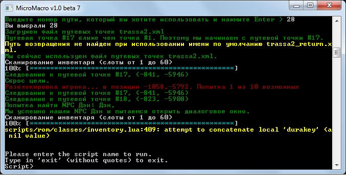

I have an error

I have 2 WP path files - exp.xml and exp_return.xml
if I die grinding with exp.xml, after ressurection bot starts to follow with exp_return.xml witch have loadPaths("exp.xml"); (updated) in correct place, but if he come to the last point of exp_return.xml and see function loadPaths("exp.xml"); he "said" Coming from returnpath then we will load exp_return.xml - or smth like that.
That's really crap, coz of that I cannot make fully automated bot.

You shouldn't be using loadPaths() at the end of a return path. It'll automatically switch the waypoint lists when it gets to the end, and I suspect calling loadPaths() in the middle could confuse it.filipsworks wrote:I have 2 WP path files - exp.xml and exp_return.xml

Now is working... THX 4 that!Administrator wrote: You shouldn't be using loadPaths() at the end of a return path. It'll automatically switch the waypoint lists when it gets to the end, and I suspect calling loadPaths() in the middle could confuse it.
